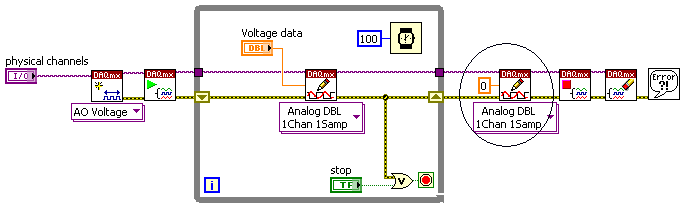

just to piggy back off of what was said....
