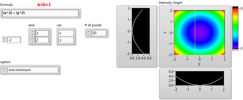

I assume you want to keep (i.e. NOT change) the intensity graph, but just display different values in it.
The formula of a paraboloid is given here: https://en.wikipedia.org/wiki/Paraboloid) , so just change the formula and potentially the x and y ranges. Also  decide on values for "a" and "b".
Is this "idea" sufficient for you?
Here's how it would look like if a=b=1
