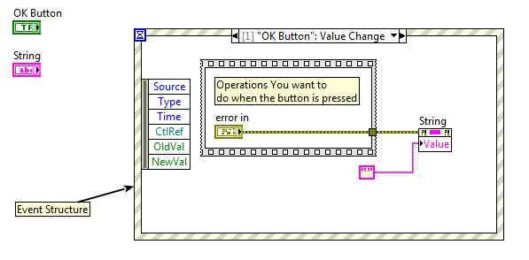

Can you please explain the method in detail, I have a string control and OK button so whenever I enter something into that string and press OK button the string field need to get cleared .. Can you help me in doing that

If you can try creating new thread along with what you tried would be more better.
-The event structure is required to listen to the OK button event.
-Inside the event strcture you simply needd to pass empty string constant to the value property of string control.
-The image exactly does what you need.
