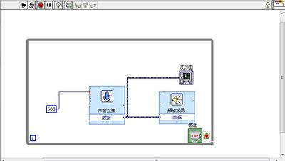

what's wrong with my VI Project?

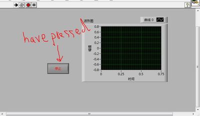

when i add a "time" project in my vi,there was wrong----i cannot stop it when i press stop".
can you help me ?  what's wrong with it ?

Hi honeyshine,
when you connect a "500" to the "duration" input of the ExpressVI I guess you need to wait for 500s for the next iteration. Due to DATAFLOW you will probably have to wait for another iteration of the loop before your VI actually stops - so worst case would be a wait of 1000s or ~16mins…
Next time you should attach unscaled versions of your images!
from  1110340027

500 means 0.5min ,it's not right?

Hi soneyshine,
in the German version that input is named "Dauer (s)", in English it should be "duration (s)".
Don't know what it is in Chinese(?), but 500s are still >8min in most countries around the world… 😄

i mean the mumber 500 is 0.5s ,not 500s

Accepted by topic author honeyshine
that input is named "duration (s)". That says it all…
Message 8 of 11
(3,713 Views)
The input to that function is SECONDS, not ms.  If you want 500ms, you need to put in 0.5.
