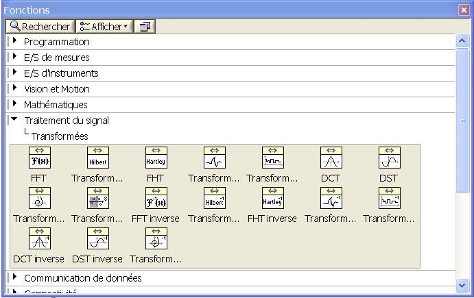

I can not find blocks in the Labview 8.5 which i indicated in attachement view. If someone knew where are they in Labview?
Please for help
Marek

FFT.vi part of LabVIEW Proffessionel Development System.
Do you use LV PDM or Base or Full Development System?
Christian

Thank you Christian,
FFT helped me a lot.

Ah, you didn't know where to find it in the palette?
If so, next time use the context help (Strg+H), from there you could also open the LabVIEW Help and there is a link under every function/block which says "find on the palette"

Thank you Cristian,
I didn't know also the name of blocks. Now i know. Thank you for your advice.
