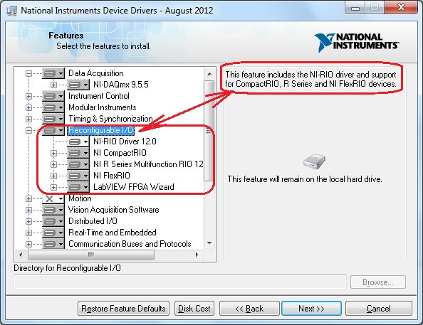

You can download (its huge) device drivers from this link.
After download, run the setup and make sure to install 'Reconfigurable I/O'.
