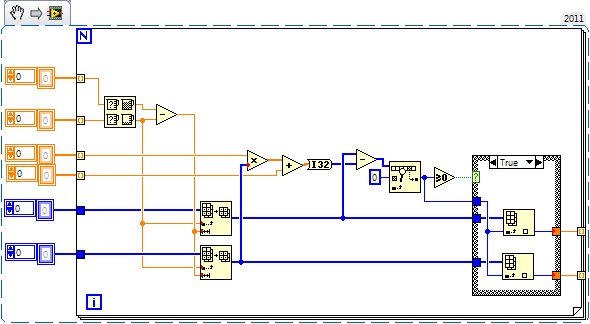

i have a problem with the following:
it starts and doesnt end. only the first "m" and "b" gets inside the while loop. afer "=" there is false. Why is this while loop standing still?

How do you know it is standing still ?
What if it can't find a true, how do you stop it ?

The stop condition is that your number has to equal zero.  You did not get a zero so the loop does not stop.  You could try less than or equal to zero for a stop condition.  Put a probe on the number feeding into your condition.

ok, that could be the reason.
Good idea with the less than or equal to zero for the stop condition.
But this would only function, if the line-value begins with a value/values less than the values of the comparing array.
So i have to set a case structure for this i think.

You could also make it without a while loop:
One thing to note about the above code. If the input arrays are not the same size the loop will only run a number of times equal to the length of the shortest array. If an empty array was input the loop would not run.

You can also use the in range (on the comparison palette) and define the upper and lower limits of when you want it to stop.

this code looks nice. instead of searching for the 0 i could square the values in the array and search for Min.
I will try this tomorrow. I think there are some other mistakes in my vi on top, because "array with x values" and "array with indizes" (the lower lines) are on 0 when the program runs and nothing varies. But the first point has the coordinates y=0, x=90.
edit: the arrays have the same length.
