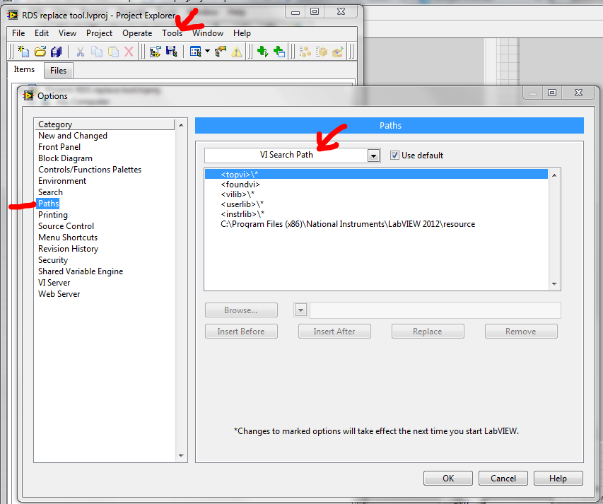

Have a look in project explorer -> tools -> options -> paths -> VI search path
Uncheck "use default" and remove the path to your .exe file (if the path is there)
/Palle
