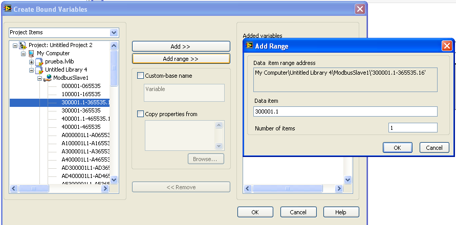

Hi Hazecks, A fast way to create Variables Binded to a OPC server for example Modbus is the following.
Add the IO server in a new library
Right-Click the library an select Create Bound Variables
In the menu select your IO server and select the range you want your variables to be Bounded to
Then add range. This will create a variable binded to that register of the OPC.
This way in a couple of minutes you can create all the variables.
If this is nor working for you, you can create the variables programmatically, you can find more details for that in this link: . How do I Programmatically Change the Data Binding Source for Shared Variables?

Hi Hazeckz, you said you were coping the Variables and changing the Binding:  "when i create a new device, i use a library per device i used to copy the variables and create a new modbus driver for the device, inside the library, im using modbus tcp, so to do this faster i copy the variables and then in the variable editor i link it to the right library name, so this sound very good"
With this you create the variables directly binded to the Specific OPC server.
Did you tried the link for creating the Variables programmatically?
