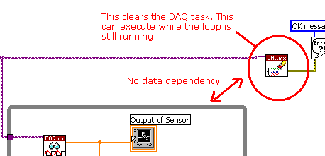

1. See figure:
2. This tells me that you're probably trying to use the continuous run button. You should not do this. Please look at the examples as Dennis mentioned.
