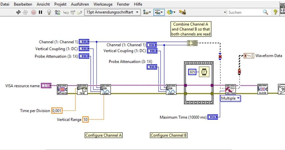

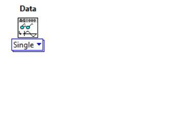

Hi everybody,
I downloaded the driver of my oscilloscope (Agilent DSO1024A) for LabView 2018 from this link:
http://sine.ni.com/apps/utf8/niid_web_display.download_page?p_id_guid=6919A42F69983EE8E0440003BA7CCD...
and there's a VI that turns to another VI when I change from 'single' to 'multi' here single.jpg
it's wierd because I just run the first example directly after downloading the driver but it lookd like thissingle.jpg
so all VI's are working but this VI (and it's the most important one)
does this mean that there's a problem in the library or maybe did I do something wrong ?
if I forgot to procure other informations about the issue please just ask

Hi achouch,
This is a polymorphic VI and you can choose among several options/instances.
So it's your problem when you change the instance in this example VI!

no i didn't change anything the example lookd like this when I opened it
and i just meant that it's because the 'multi' version of the VI is not working correctly
(3,485 Views)
Accepted by topic author achouch
Hi achouch,
Maybe someone else changed the example VI and saved it (accidently)…
(I don't think they ship a non-working example VI.)
That "multi" instance will work correctly on its own.
You ned to cleanup and debug that wiring in the example VI…
(3,459 Views)
