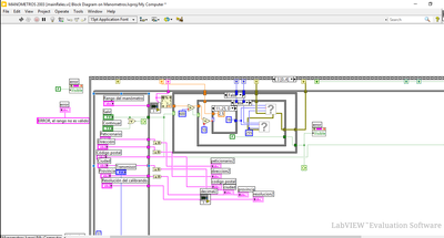

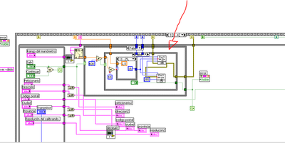

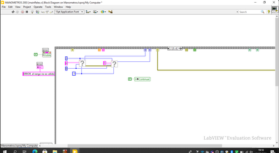

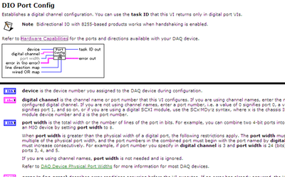

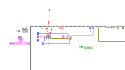

Hello everybody,
I have a problem with the “DIO Port Write” and “DIO Por Config”. Those are a very old version of “NI-DAQ function” I think.
So, right now I need update this program from 32bits to 64bits but this DIO Port Write and DIO Port config don’t run. The update is necessary because the computer was update from Wxp (LabVIEW 8.2) to W10 64bits (LabVIEW 2020).
Do you know any other VI that work like DIO Port Write and DIO Port config??
I attach some figures to show the problem.
Thank you very much!!
Message 4 of 8
(3,067 Views)
Hi Miguel,
As I suspected you are trying to use code with that old NI-DAQ routines.
And as Rolf explained you need to change that code to use NI-DAQmx instead!
When upgrading a >15 year old computer system you really should take the time to upgrade/improve the whole system, including the software. Now it's a good time to cleanup those VIs…
(In case you don't use any SCC tool by now: get such a tool running before you start to edit your LabVIEW VIs/projects!)

Hi Miguel,
DAQmx works in a different way than traditional DAQ: you create a task by selecting the included channels, then you can start the task and read from/write to it - as is explained in all those example VIs coming with LabVIEW+DAQmx!
So there is no specific function to replace "DIO Port Config", it's (mostly) all in DAQmxCreateVirtualChannel…
