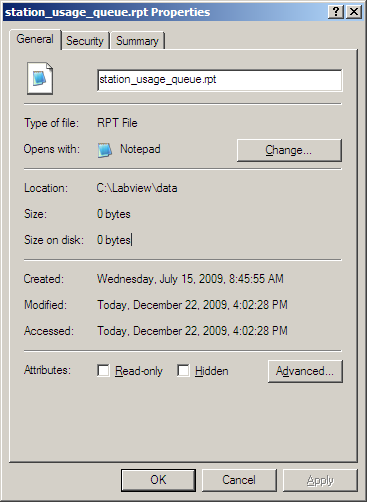

The file created by the open/create/Replace VI attributes are NOT set to READ ONLY. See the pic below. If the LV creates the file it should be able to subsequently write to the same file. Once again this is LV version 6. It didn't work this way before... I took a look at a few things in the code and noticed this anomaly.
BTW, there are root or branch level folder showing the Read Only attribute is inherited from parent folder... but my whole C drive is this way... but LV should be able to write to the file regardless....

The above code works just fine on my virtual machine running LV 6i no matter how many times you run it.. Is your screenshot based on the first write, or a subsequent write? It shows 0 bytes.
Why? LabVIEW does not override the file system's permissions, but this would not be due to the "Read Only" attribute for a folder. This is basically meaningless on Windows. For a folder what matters is the Access Control List. Assuming, of course, that you're dealing with an NTFS file system.
