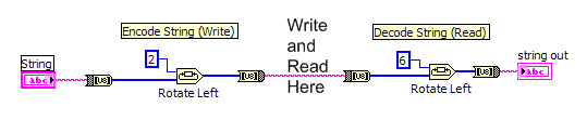

You haven't really defined how secure you want your data, but if you just want a simple way to hide the information from a casual user, this may work.
Obviously, if someone really wanted to, they could figure this out.
steve
