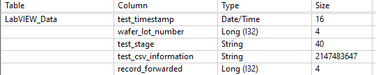

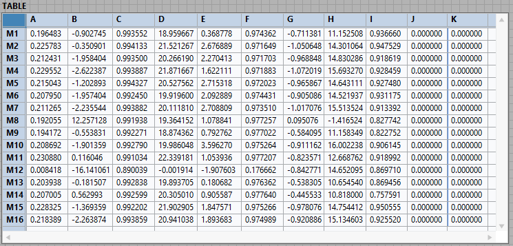

Of course I can write the row and column header as a 2D to the database table. I would like the row-column header along with the data in the test_csv_information column.
Attached VI shows how I upload a sample 2D data to the DB. However, the table (as shown below which is a front panel indicator) has column and row headers, is there anyway I can send the table data along with its column and row headers directly as a 2D array to the database?
NZuaJKg
Its a Microsoft SQL DB, No I use the same table for every measurement differentiated by the first column : TimeStamp value.

I don't have LabVIEW installed at the moment (new computer... long story)
Well you can only write one data type at a time.
You are going to have to break this up into several writes.
Or convert everything to a string array to write it all at once.
Frankly I do not like writing all my data in one shot at the end of a program or test. Because if the program crashes or fails for some other reason before the test is completed. I would rather have partial data than no data at all. So I save my data a line at a time as soon as possible after the data is taken
