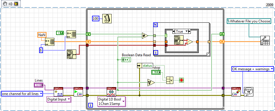

OK,  so I think I have a better feel for this.  Essentially, you have 6 switches; the switches will be toggled once to true (apparently with no clear pattern); when the switch is toggled, no further action can be performed on it; finally, when all switches are toggled to true, the VI completes and the task clears. This is the expected operation no?  Try this below.  (for the sake of simplicity, I use only one set of channels)  Cheers, m

Blizabeth,
I believe that we can assume that all switches start in the same configuration and therefore have the same start time, no?  That is the call to the Get Date/Time in Seconds.vi at the beginning (only one needed).  Then, we are simply looking for when the value changes for each individual switch.  The time difference is recorded in the array of 6 doubles.  If you need to, you can basically duplicate this for the second set of channels as none of the code changes.
