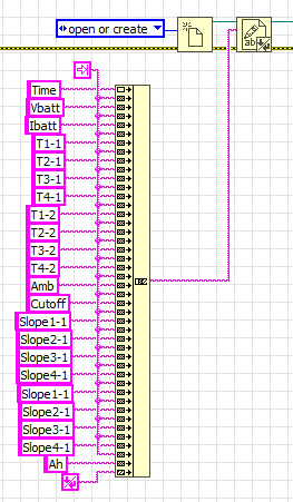

Okay first off you need to forget the "Write to measurement file" Express vi. Express vi's are intended for those half day LabVIEW sales pitches  seminars, to show how fast you can just throw something together. But as you see they are not very useful when it comes down to it.
Writing to a file with column headers is a multi step process.
  1. Open a file
  2. Write headers (text) to file
  3. write data (numeric) to file (repeat until done)
  4. Close file
Here is an example of steps 1 and 2
You have to now pass that file reference to the rest of your program (use a shift register)

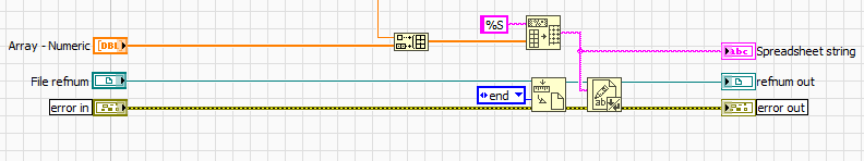

Step 3 can be accomplished with this VI I wrote a long time ago, it takes a numeric array and appends a timestamp then writes them to one line of a tab delimited text file. These files can then be imported into Excel with ease. I will attach this vi. Note the file reference input is used.
Inside it just formats the time stamp and does this:
I would strongly suggest to replace the above code with "array to spreadsheet string", using an array of header strings (which you often already have) as input. The default delimiter will give you the identical result, including the termination.
Can you explain the reason to use a format of %S here? I don't get it.
