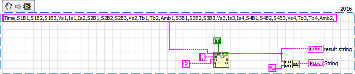

Now just do a little sub-vi like this to format the headers...
This allows me to quickly change, add, or, remove headers by editing one line of text.

To get a "print", you can print the above image. To get a VI, just recreate the code. It is simple enough and should not look any different in 2014. Is there any part you don't recognize?
