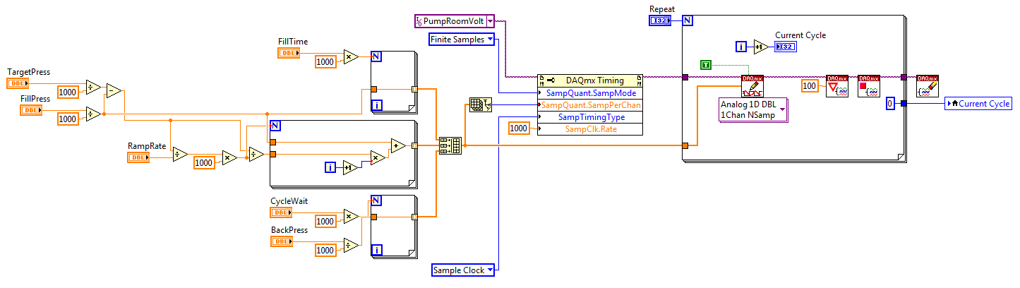

I had to do a very simple single voltage ramp the other day. This was my solution... maybe it will help.
Edit: The 1000 you see wired all over the place is the sample clock rate. I basically did everything in ms for simplification.  That middle for loop is the one that actually does the ramp.  The other two are just wait times at top and bottom of the cycle.

Edit:  My math may also make more sense if I told you that the first division (Target Press / 1000) was conversion from pressure (0..10,000 scale) in to voltage (0..10 scale).  The way the math worked was:
1: Find voltage range you are ramping over (V_final - V_initial)
2: Find how long it will take to do that given ramp rate (V_f - V_i) / (rate)
3: Multiply by 1000 to get it in to ms
4: For each ms, voltage = i*dV + V_i
Where dV = voltage range / number of points.
Why didn't you just use the Ramp Waveform VI?  It would be so much easier.

Well, since you asked... I have a tendancy to do simple math like this myself in most cases. I trust it more, I know exactly how it is going to act in situations, and I find that it easier and takes less time for me to just program it than it does for me to load up the help, figure out exactly how the VI works, and then dump it in.

If this hadn't been a one time use quick program, yes.  It would be a sub-vi and all of the "1000" constants would be variable instead.
