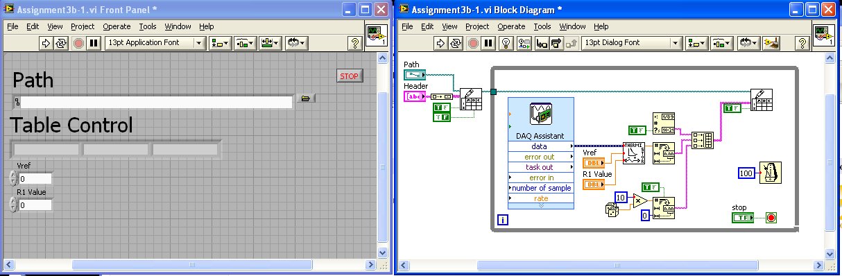

            thanks for the reply. see attached for the VI. Im new to labview so im not sure about the format.

just some more information. i am trying to write to spreadsheet from 3 sources  - a time stamp, a random number generator and from an external thermister-resistor circuit. the results are then logged into an excel file. but i am getting header information for each data point recorded. see first post.
regards,
Jason

You have two write to Spreadsheet files.  And worse, you have a race condition between them.  It's possible that the writing to the files can happen in any order because they are operating in parallel.
Set them to operate in a sequence, and that the header part only writes on the first time through the loop.
