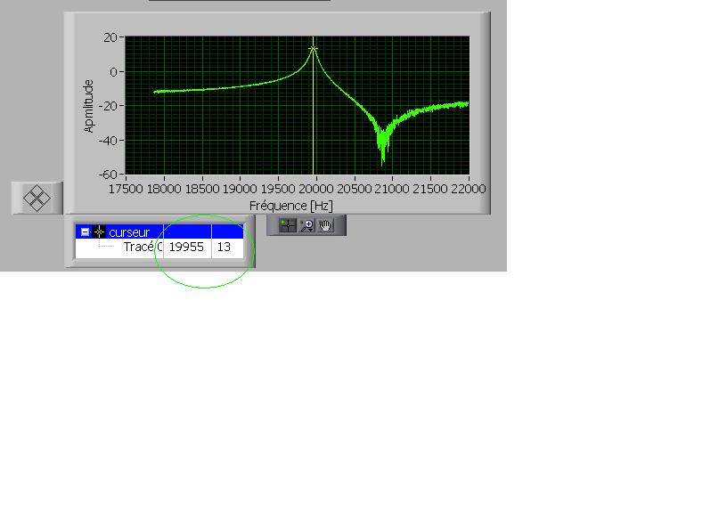

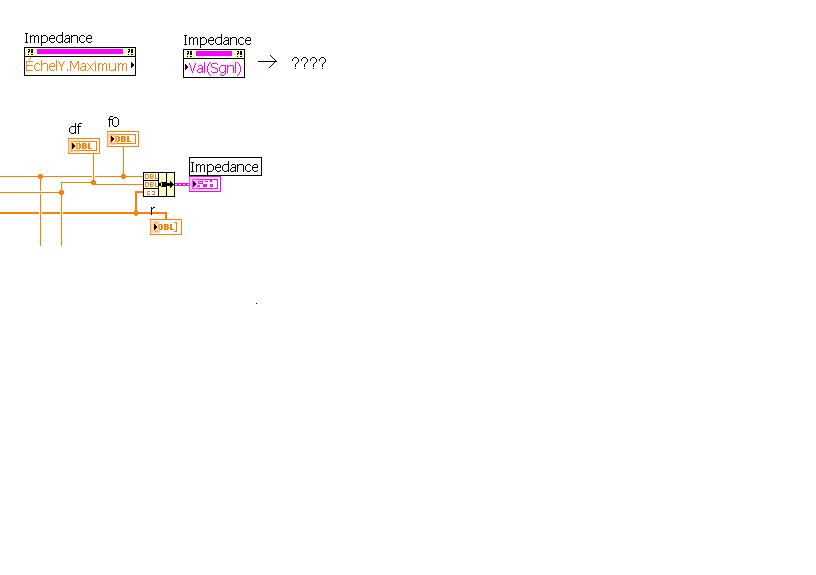

So, how can i get a value x of max y value from graph? I've attached two views. I knew how to take max from array but in my block digram for marque a graph i've used 'df' and 'f0' - how can i turne these on good value whith one will be good present as in the graph. Whot i am going to do is just take a x=f(ymax).
If you can help me, please?

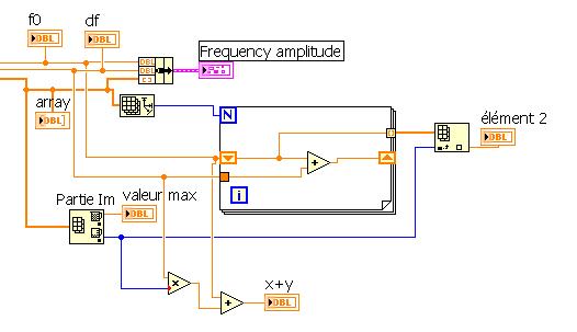

Thank for Your reply,
My issue is that, I don't knew how to take index value from two parameters df and f0?

Hi Gfds,
Your 2 paremeters df and f0 are not arrays, they are single double values?? You have made a cluster out of 2 double values, initialised an array with them but not set an array size, giving you an uninitialized array and then tried to index it?
If you can post some actual code rather then just a glimpse we may be able to see what you are trying to do and help. Is not all that clear at the moment.

Hi Gfds,
Just realised what you are after:
I beleive this is what you are after.

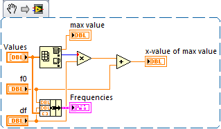

Here without Goldberg:
Norbert
Edit: Lucither bet me 😞
