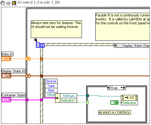

Another trick is that you can force an XControl to be an indicator (or control) ONLY:
Ton
