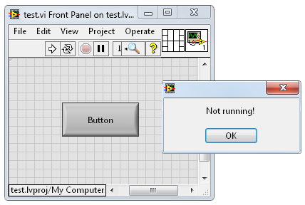

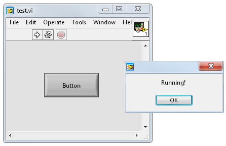

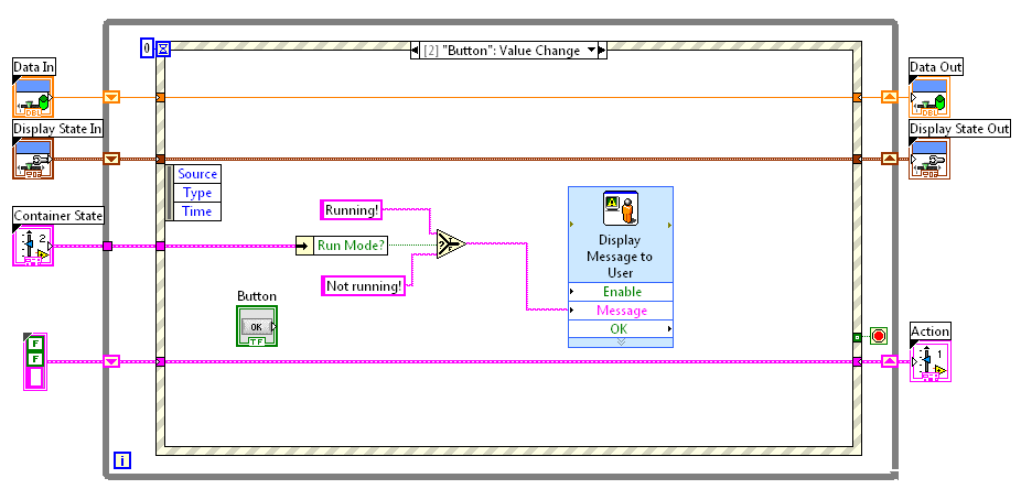

I have an XControl with an event for a push button:
If I drop the control in a VI and press the button, I get:
If I build an exe and start it, pushing the button yields:
Thing is, I haven't started the VI yet!

I guess the XCtrl data always shows that in an EXE because it assumes the VI is always running, even though the white arrow indicates it should be in the Idle state.
In any case, what's your actual use case for this? It's unusual to have an idle VI in an executable. Normally, the UI shown to the end user should always have running VIs and never show the toolbar.

"Run mode?" is not the same as running. You can switch a VI to run mode using ctrl+m in which case the VI can no longer be edited, but it is still not necessarily running.
After building an executable, a VI can no longer be in edit mode, thus it is always in run mode, running or not.

There are couple of properties you can read to determine
1) if you are now in executable or development mode (App.Kind)
2) if you are running or not (Exec.State)
(screenshots attached)
