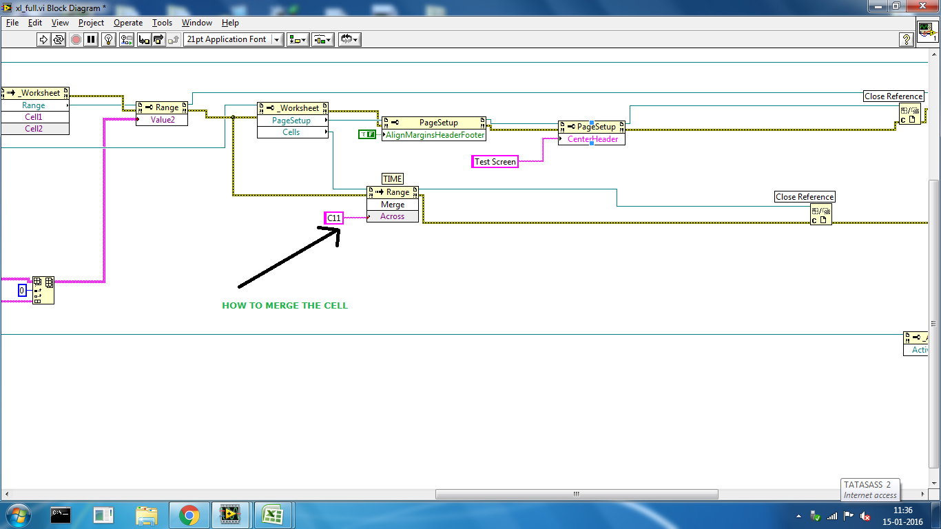

HI,
          how to merge the cell.i try to this image format but return the error .i thik i given input is wroung so pls tell me how to give input to merge property node.

How many times to we need to ask you to send VIs, not pictures of VIs?  Do you really expect us to look at a picture of your code, open our copy of LabVIEW, and spend the time to duplicate what we can see of the code you sent?  If you want us to help you, please, make every effort to make it as easy for us as possible!  Is that difficult to understand?  Post Code, Not Pictures.

OK, now I see the Merge.  It is curious that you specify the Merge Range backwards (C2:B2).  Not wanting to look up ActiveX, I looked at how the Report Generation Toolbox does this (I also searched the Web for how to Merge Excel Cells using ActiveX).  It's not particularly pretty -- you need to create a Range Object from B2:C2 and then use this as the Range argument to the Merge Method (with, as near as I can tell, Across unwired).

Of course you need to wire a reference to the range you want to merge to the Range Merge method. Right now you wired a reference to the worksheet cells range so guess what you are trying to merge: all the cells of the active worksheet. Probably not what you want.
Across is an optional input that takes a boolean input (default is FALSE). Now go to Excel and select an empty 2D range. In the Home tab click on the small arrow at the right of "Merge and Center" to open the dropdown menu and select "Merge Across". See what setting across to TRUE is doing? It is merging the cells of each rows separately instead of merging everything to 1 big "cell".
