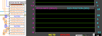

y axis not following property node?
The secondary y-axis seems to not following the property node.
I want the secondary Y axis to be in increments of 6.  Despite explicit definition, it defaults to 5 for some.
what am I doing wrong?
Thanks!

Hi fan,
You don't attach code to your message…
Suggestion: enlarge the graph in Y direction and try that property node again…
(452 Views)
Accepted by topic author shuttlefan
Turns out the issue was a property node in a different part that had an error.  So that prevented the following properties to be applied.
Lesson learned:
Do small sections at a time, and check for errors of each section.
(393 Views)
