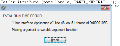

However, if you don't put the 4th parameter or it has an incorrect type, you should get a run-time error in Debug configuration with run-time checking enabled(Debugging level set to Standard or Extended in Build Options).
