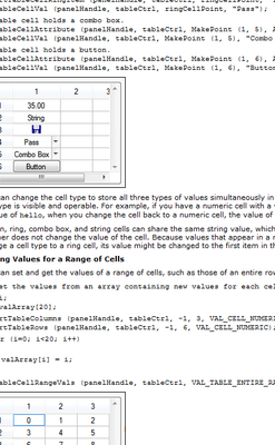

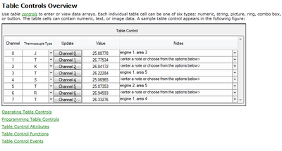

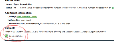

Do yourself a favor and click on your table control.  Then hit the F1 key on your keyboard. Up pops the most wonderful tutor for LabWindows: the Help window!
No, seriously.  Do that right now.  That's how I cut my teeth and so can you.
There are truly excellent articles on calling convention, examples, theory of operation, etc.
There are even example projects in there that will launch right from the Help...
