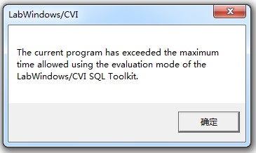

hello ,
    About CVI SQL Toolkit2.2,why did I get the following error in my program after open it after a while?

The SQL toolkit is not a free software: either you have a bundle that includes it (e.g. a Developer Suite) or you need to purchase it separately.
Which version of CVI are you using?
Programs created with an evaluation version of CVI or one of its toolkits have a limited execution time allowed (I seem to remember 10 minutes): as far as I can understand from the message you are in this situation.

Thank you my friend,maybe i need to buy the licenses.
