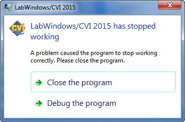

Just recently, I can no longer Save a file, Save As a file or Open any file from within CVI. CVI quits instantly, with the message popup below.  Doesn't think about it, just instantly.

What do you see when you click "Debug the program"?

This is what I see if I select Debug:
When I click Debug it relaunches CVI.  Tried at that point to Save unnamed project, and it quit.

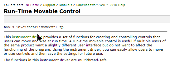

Roberto,
Is this really where you were sending me to install something?
Message 8 of 13
(7,706 Views)
Of course not! Smiley Embarassed Seems I have linked the page I was visiting for another discussion!
