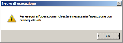

the first time I execute the distribution setup.exe I get this message:
which means "To run requested operation it is necessary to execute it with high privileges". After pressing OK the message disappears and that's all.
After successfully installing the distribution, if I execute setup.exe again I get the window you posted, with the only difference that it recitates:
    Program: setup.exe
    Author: Unknown
    File origin: local hard disk (I have copied the distribution on the PC)
