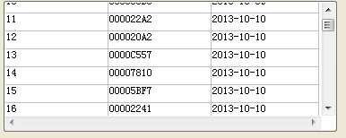

Thanks for your reply.
My situation is not like this . Let me show you clearly.
1.I have an empty table
2.I have an excel like this
3.I called function ExcelRpt_ReadDataToTableControl(worksheetHandle, cellRange, MakePoint(1,1), ExRConst_InsertRowAndColumn, cmdpanelHandle, PANEL_2_TABLE_3); and I got this
4.My purpose is modify the date items in the table and export a new (not last import file) excel file (.xls)
so I used ExcelRpt_WriteDataFromTableControl(worksheetHandle, cellRange, cmdpanelHandle, PANEL_2_TABLE_3);
and I got an excel like this
this is not what I want , I need 00007810. that is my problem ,Thank you very much.

I tend to say that the problem is Excel trying to be "smart" Smiley Surprised
I have no real confirm on that, but I noticed that all dates (e.g. 2013-10-09) have been converted in another format (2013/10/9) while I suppose you are not doing anything about those cell format. This makes me think that Excel recognise those texts as dates and format them in some standard way it has in mind.
In the same way (I suppose) it recognises "00007810" as a number and applies that format, while "0009DDA" cannot be interpreted by the program as a hex number and is left as text.
I'm not sure whether it can fix the situation, but can you try to assign text format to the columns before importing data to Excel and see what happens?
