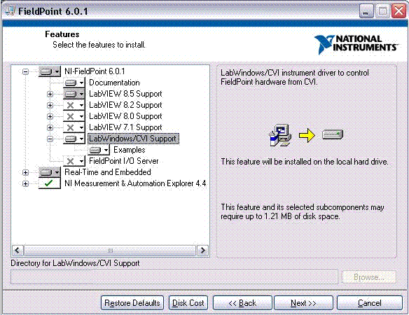

The information in my last post is specific to using FieldPoint with Real-Time.  If you are using a Windows system, there are a number of examples available for use with FieldPoint.  Verify that you have installed support for CVI with the FieldPoint driver, as shown in the screen shot below.
From there, the examples should be located in the following file path: C:\Documents and Settings\All Users\Documents\National Instruments\CVI\samples\FieldPoint
