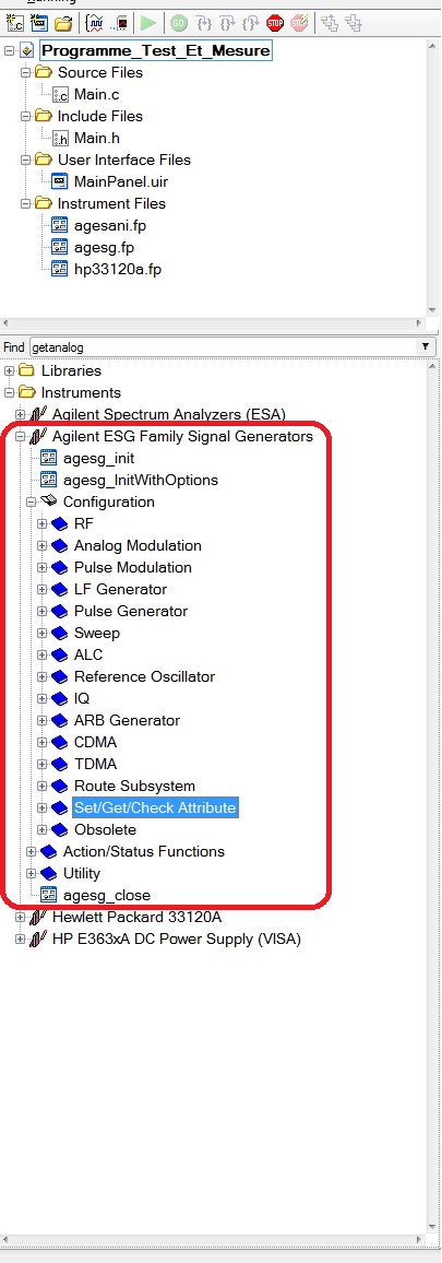

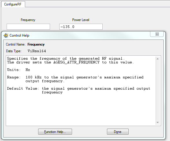

when you expand the tab "RF" that is listed unter "Configuration" then you will find some
functions. One of them is agesg_ConfigureRF.

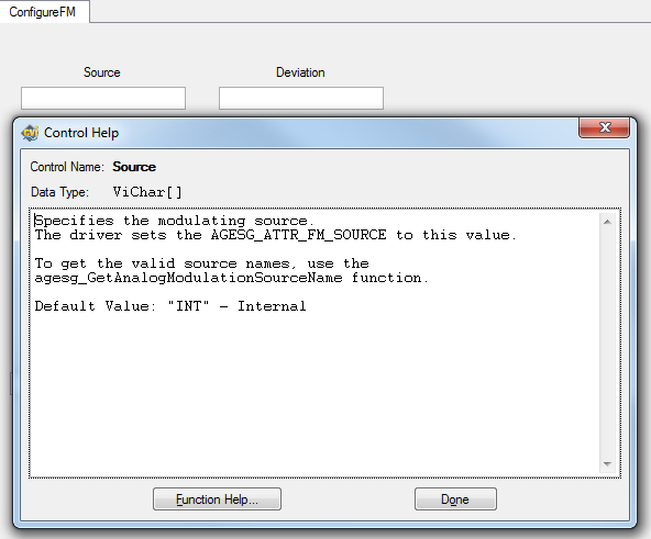

Then there is another function -> agesg_configureFM where you can specify your modulation source..?
At the path where you installed the drivers you can find a help document. -> agesg.chm
This document will provide you with lots of infos.
Are this infos helpful for you?
Or could you please discribe your problem with more details.
