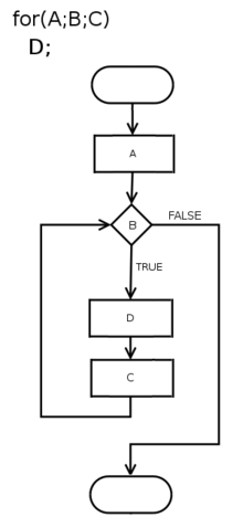

Being relatively new to LabWindows CVI or C as such( at professional level), i am confused whether or not to avoid goto statements in the code. I have often read that it is not a good practice to use a goto statements excessively and using it to jump backward.
I have a test sequence which is in the form of a flow chart, where there are various types of condition checks and associated branching. I couldn't figure out a way to implement the algorithm without using goto statements. I would like to know, what would be an ideal way to do this without use of 'goto'.
For example consider the flow chart shown below.
After process C , the program should loop back to B.
Can someone guide me on this? or is it ok to use goto statement in this scenario?
Best Regards
Waiting For the inner calling 🙂

Hello
I have diferent option depends of the number of steps in your secuence.
  1. First:
    while(B)  //
        D;
        C;
    also a "for()", but incluying a "break" for end
  2. Second:   if you have more steps and this steps have jump,  the solution is a states machine
while (state != no_end){
    switch (state)
    case  A:  //  code for state A
              //  next state
            break;
    case B:   //  code for state B
            state = end;
            break;
    case C:   //  code for state C
              //  next state
            break;
    case 😧   //  code for state D
              //  next state
            break;
Regards. Jose Angel..

Josse already mentioned it, best way of implementing a flow in C is using switch-case model.
It is very neat and easiliy maintained. Each state is separated in case statments so you do not get lost in the code. You can immediately find the relative part and it is easy to code because you simply follow the same original train of thought which also helped you to draw the flowchart.
Goto is somewhat inevitable when you try to implement a consistent error-handling within CVI. That's the only point I let myself to use goto's. Otherwise I do not use them.
