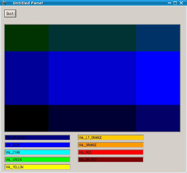

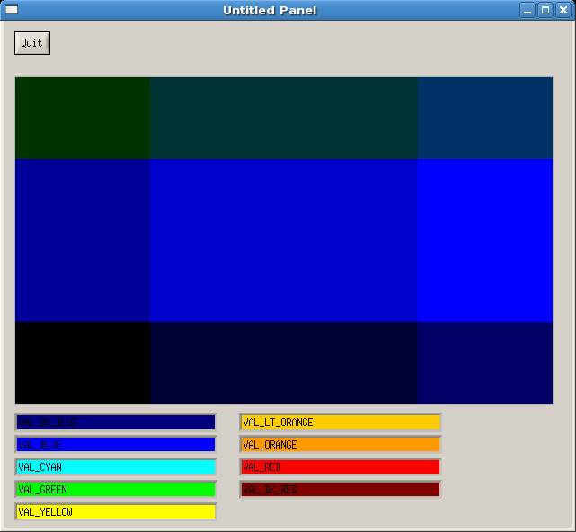

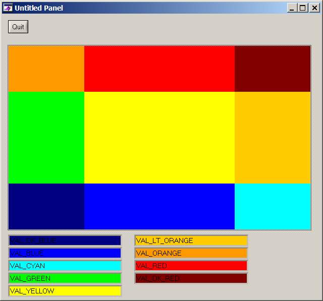

I also presumed an error in the ported code and so created a small test application which is attached.  It actually displays the colors used in the colormap fine when used as the background to text fields.  But the colormap is still bogus in Linux - not in Windows.

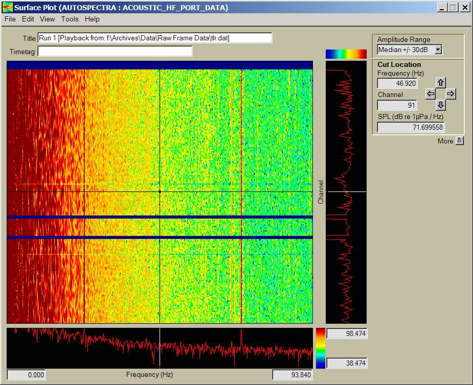

Application running in Windows XP (Normal Operation)

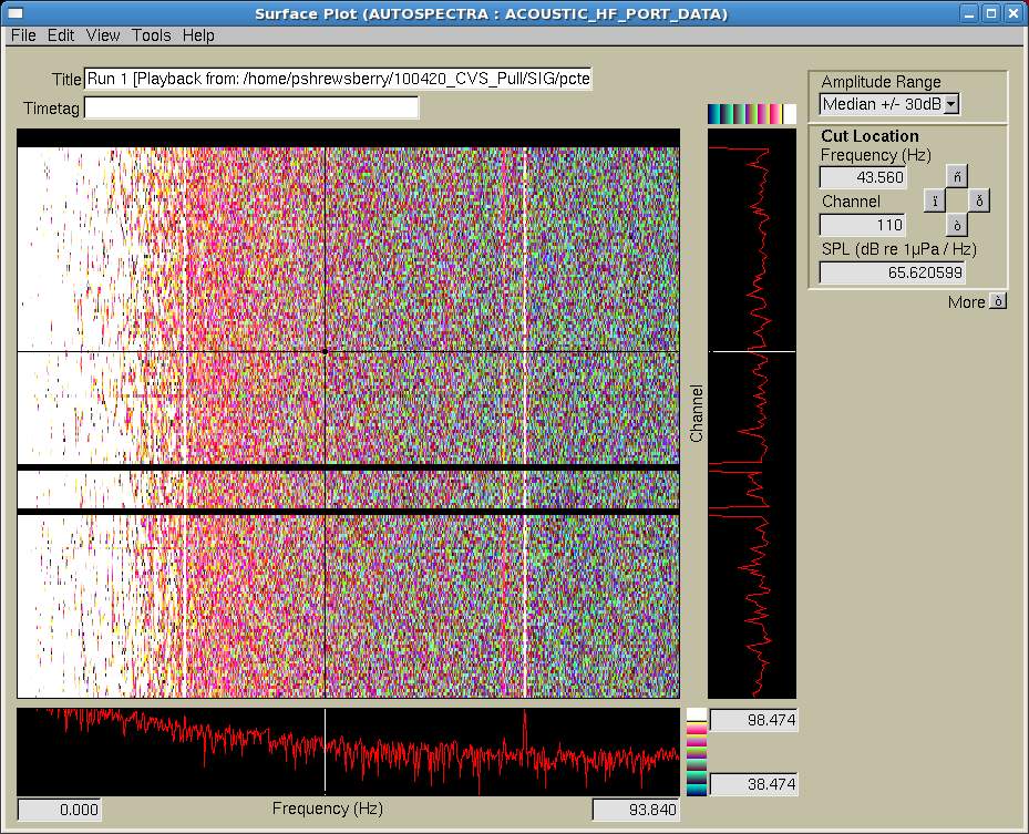

Application running in Red Hat Enterprise Linux 5.2 (PlotIntensity call not working)

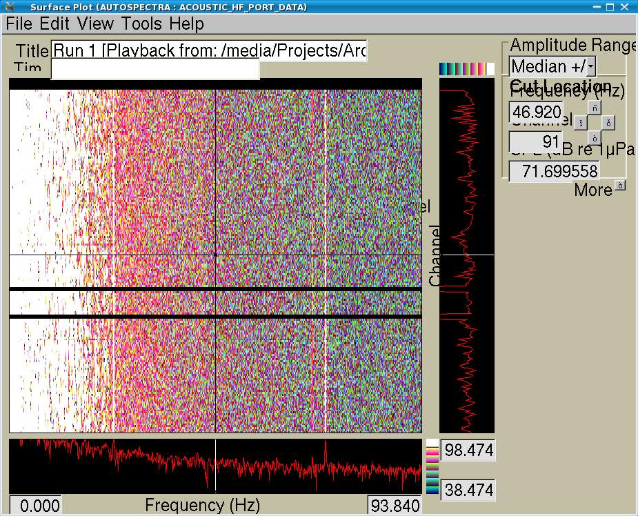

Application running in Mandriva 2010 (PlotIntensity not working)
Test app running in Windows XP
Test app running in Red Hat Enterprise Linux 5.2
Test app running in Mandrva 2010
