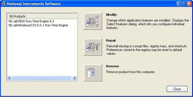

This is a serious issue.  We are distributng the CVI 8.0.1 runtime engine with our products and our customers are having this installation problem all over the place.  It seems to be custoers with otehr NI products installed.  But if theyuninstall everything else the CVI8.0.1 runtime continues to show this problem.  It pops up this error message and and asks to repair the installation, then it requires a PC restart.  When the PC boots, the same error message pops back up.

This same issue started happening to me after I installed NI Vision and Vision assistant. Even after I uninstalled these VIsion stuff and reinstalled Labview core software, the same phenomenon continues to happen, asking me to install the RTE and reboot the machine again and again.

I understand this is rather old problem and have been solved in a newer version of LabView. Since we however have to use an older version and this is extremely annoying (you know, after uninstalling everything, it still remains...), I'd greatly appreciate it if someone could let me know  a clue to sort this out.
