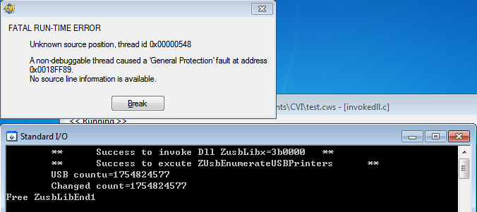

A customer using LabWindows/CVI 2013 to call a VB dll, it can call the function in the dll successfully, but leads the LabWindows/CVI Crashing when leaving the CVI.
 The CVI will crash after finish the last line of code. If I remove the 6th line "#define Test", the code runs ok since it will not call the function in dll. If I recover the 6th line, the code will get Error as belowError信息.PNG
The code is shown below.

Hi
You've declared two pointers to integers:
 unsigned int *Count;
 signed int *Changed;
 when you should have simply declared the two integers:
 unsigned int Count;
 signed int Changed;
 They will be converted to pointers by the "address of" operator "&"  when you actually call the function:
 result= DLLFAddress (0, &Count, &Changed);
 With this correction your code does not crash anymore.
