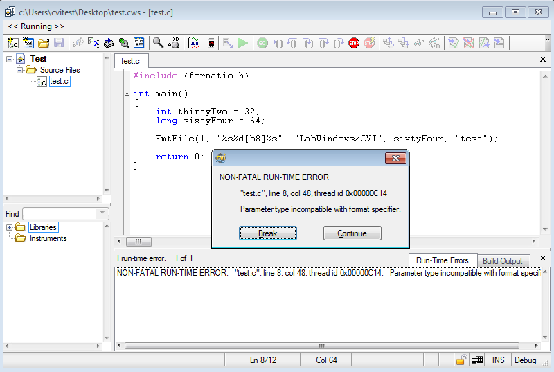

Hello Wolfgang,
I tried reproducing the issue you've described and I received the following message:
I too tested with LabWindows/CVI 2013 SP1 (build 201), and I received the location information. Are you receiving a different message?
= Nelu F. || National Instruments.

I just realized that you have used long (32 bit) - whereas I have used long long int (64 bit)...

Hello Wolfgang,
I reproduced the error as you described it in the Debug64 configuration only. In the Debug configuration, the source location was specificed, so I have opened bug 472987 to track it. The issue appears to originate in LabWindows/CVI 2013.
Are you also seeing this issue in the Debug configuration? If so, could you please provide a sample?
