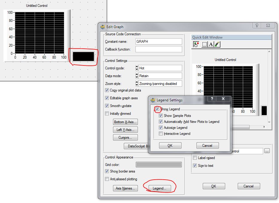

It's been a while since updating graph controls.    On a new project in CVI Version 10.0  Every time I add a new graph control I get a button attached to the side of the graph.  I want to delete it.   I do not remember it doing this in version 6.0.   How is it possible to hide it?

If you are talking about what I think you are talking about, then this is not actually a button. It is the Legend for the graph. You can disable with the Legend Visible property or with the Show Legend check box in the Edit Graph dialog as shown below.

Thank- you a bunch.......  That is exactly what i needed.
