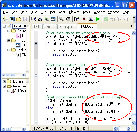

When I enable the support for characters in Chinese on my XP machine and I open the CVI files they are shown like this:
CVI
What do I need to do to get this working?

When you change the "Language for non-Unicode programs" to be Chinese, you are modifying the native code page for every non-unicode program running on your pc.  As you've noticed, this is what allows you to display Chinese characters in both TestStand and LabVIEW.  However, it is exactly this setting which is "changing" your CVI code.  What is happening to your CVI code can be pretty easily explained - in the strings you have circled in your first post, you must have a character whose ascii value is higher than 128 (such as ‡ or »).  When you change your "Langauge for ..." to be Chinese, this high value character is interpreted as a lead by in a dual byte character, and when combined with the following byte, the dual byte Chinese character is displayed.  The contents of your file haven't changed at all, but the font you're using is now interpreting those contents differently.  I would guess that if you copied the same string into LabVIEW or TestStand, you would see the same result.
The truth of the matter is that you don't actually need to change this setting on your development machine.  When you compile your code and include the dual-byte strings (that show up as ???? when your language is set to English), those strings will be displayed as dual-byte Chinese characters when deployed to a computer that has enabled Chinese as the "Language for..."
What's unclear to me is what you're trying to achieve in CVI.  What do you want to be displayed with Chinese characters?  Is it strings on your UI?  Strings in your source code?  Can you please clarify exactly what you're trying to do with CVI, and what isn't working?
In short, when you change the language on your development machine, your strings containing what are now lead bytes in a dual byte character string will be displayed as dual byte characters.  CVI is not modifying your files, it is just displaying the string you entered in the context of the new code page.
