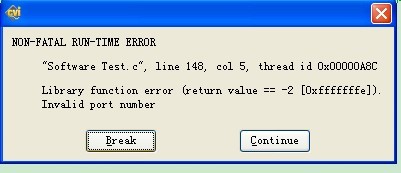

I meet a problem .It always occurs "Invalid port number" when enterring into debugging interface before I could open the port and it breaks.

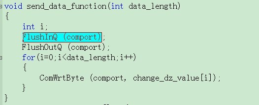

The program hardly  breaks when it enters into the debugging interface. I could not have enough time to press the command button.
I find it goes directly into the line FlushInQ (comport ) from the main function when I set a breakpoint in the main function.
So I think the error indicates that this might not the case.But I could not find where is the mistake. I would appreciate it very much if you could help me check my code thoroughly.

your debug screenshot nicely confirms the suspicion that your function send_data_function is called before you have defined and opened your port. You will need to fix this.
One solution possibly could be to start the timer calling send_data_function only after you have successfully opened your port.

the UI timer is enabled in your panel, which means that when the program starts timer callback begin to fire regularly, even if the port has not been opened yet. You can set the timer as disabled and enable it on opencomport callback.
With reference to this function, there is an evident typo that makes the program close the port immediately after it has opened it!.Place a breakpoint on openComConfig function and execute the code line by line (with F8) to see what's happening.
