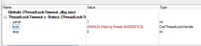

I see I can add the function call to get the thread id of who has the lock, but didn't see anythign in regards to debugging that says it.
PS I did find my bug after figuring out the thread, then adding a breakpoint there.

My program has a few threads running.  I ended up solving it by adding the getID function calls before the lock up and then viewed threads actively in my debugger.
What I was looking for was a way to view the holding thread of the lock in the debugger but couldn't see how to do that.

If you're using a CmtThreadLockHandle, and you're using CVI 2009 or later, you should be able to view the owning thread of a lock. For example, this is what the Variables window shows me, when I debug the ThreadLockTimeout example:
