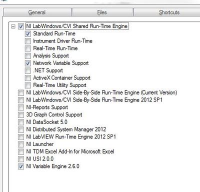

 By the way, the RTE components I am using are shown here:
