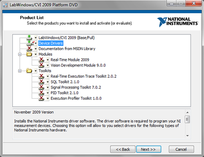

I'm moving to a new PC and am stumped on this one. Where do I select "Interface to Win32 API" in the image below?

Interestingly, when I dig out my older installation discs, I do get that option:
Explanations / suggestions welcome.

I noticed that when you install CVI 2009 for the first time, the option "Interface to Win32 API" is missing.
But after you installed CVI, if you use the same disks to repair or modify the installation, you can see this option.
I installed the Win32 API interface in this way.
