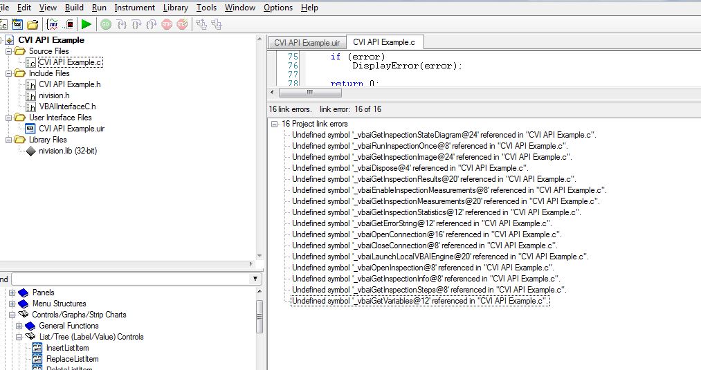

I just run the project <NI Vision Builder AI> \ API Examples \ Examples CVI and that's what I think every time:
Well, I corrected some errors that I added to my nivision.lib project, I tried to do the same with these errors but there are more files. Vbai lib ... Please, help me to solve this problem ...

I have changed the VBAI-API Header-File:
#if !defined(VBAI_STDCALL)
    #if !defined(__GNUC__)
        #define VBAI_STDCALL __stdcall
    #else
        #define VBAI_STDCALL __stdcall /* Changed ! */
    #endif
#endif
See also http://forums.ni.com/t5/LabWindows-CVI/execution-error-Undefined-symbol-imaqCreateImage-referenced/m...
