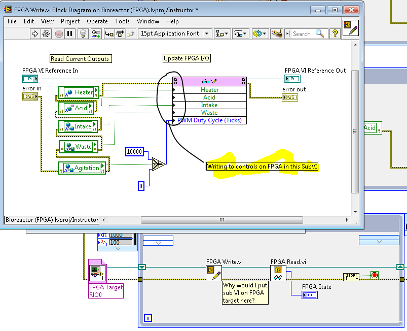

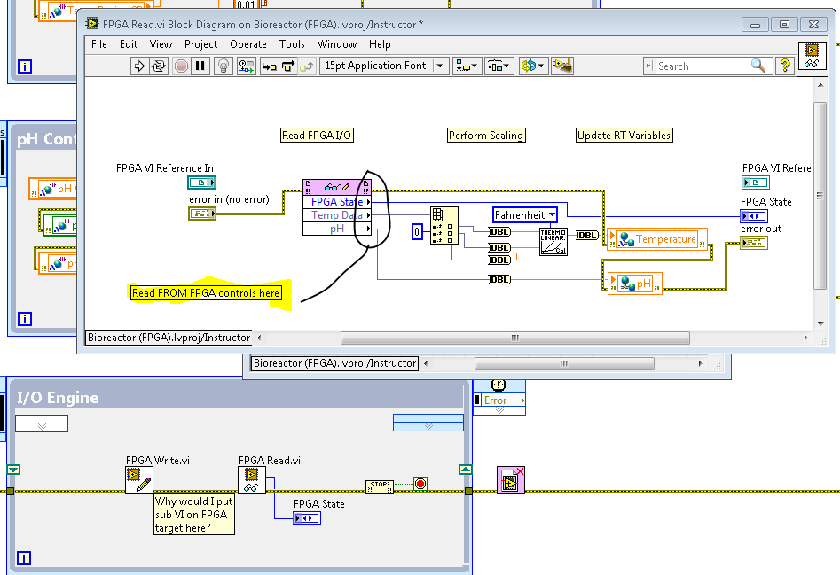

I have a hybrid code (which I cannot post here but will use the attached as an example) of a VI on the FPGA target that is just a group of digital inputs. The rest of the code is on the Real-Time target. I understand there needs to be a DMA FIFO to pass information from the FPGA to the Real-Time target so the Real-Time target can share that with the host.
This is a two part question.

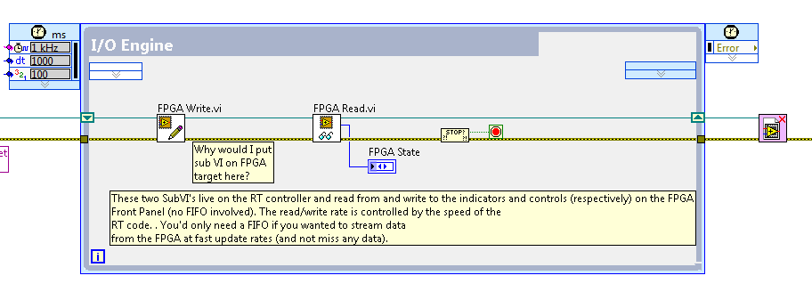

1. Why wouldn't the VI that's on the FPGA target be included in the block diagram of the DMA FIFO VI, say in between FPGA Write.vi and FPGA Read.vi, or some other place in the VI that passes through the digital input readings to the RT Target & Host?
2. Also, the RT-Target will need to collect the readings from the VI on the FPGA. Will I just drag in the VI that's on the FPGA into the VI on the RT-Target that's performing the control in my control system, say in a while or time loop and does the VI from the FPGA target need some conditioning in the RT system control VI?
See the note in RT Main.vi --> Timed Loop "I/O Engine"

You only need a FIFO if you need to stream data without missing a single data point (since typically the FPGA loops will run much faster than the RT loops).
The write/read step on the RT side directly updates the controls and reads from the indicators when the RT loop turn (hence the Reference to the FPGA VI loaded in RT Main). This will happen at whatever rate the RT loop is turning. If you need this to happen faster than the RT loop can turn, then you need a FIFO.

Another note, when speed is not an issue (measuring temperature for instance), I often bypass the RT controller completely and have the host PC VI read and write to the FPGA directly...

Tommy,
I understand the example that was uploaded may not represent what is being asked and may confuse matters more than doing good.
1. In my code, the RT Target needs to process data read by the inputs on the FPGA target for the control system to work. The main reason for using the FPGA is because of the high frequency of the input device.
2. There's complex code in my "FPGA Main.vi" to allow for the RIO to read from the input device. So it's not as straight forward as dragging and dropping the I/O on the FPGA target into the FPGA Read.vi and FPGA Write.vi block diagrams, at least I don't think so. I might be wrong.
3. I am assuming the RT Target will be the host so it will have the ability to run headless and the HMI will be only for monitoring and adjusting settings as required. However, I am fairly confident there needs to be a "pass-through" for the HMI to show performance.
So with that said, would I drop my "FPGA Main.vi" into FPGA Read.vi and FPGA Write.vi block diagrams? My "FPGA Main.vi" would have terminals assigned to it and dropped in, in lieu of I/O.
