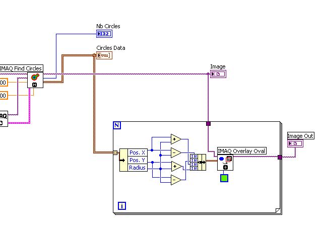

我想利用IMAQ Find Circles 函数对圆形颗粒进行计数,要求可以在每个识别出的圆形颗粒上加一个小方框或小亮点作为标记,但不知道怎么加,效果图在附件中,谢谢。

Did you try using the overlay circle?

Thank you very much,but could you tell me how does this part work,.2010-05-20 00 18 47.pngI don’t understand the principle about this part,thank you.

This is how you define circle if you know the centre position and radius.The overlay oval requires a bounding box input. So you have to feed Top,Left and Right,Bottom.
