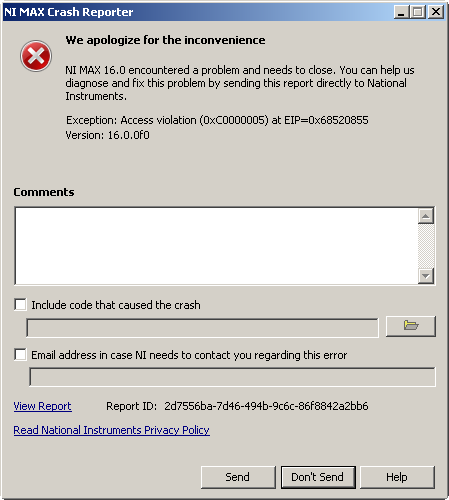

The new camera works perfectly with amcap so the DirectShow drivers are working. However, when I use NI MAX and click on the camera it crashes and I am given the attached error report. This also happens when I try to access the camera in the LabView Vision module 15.5. Any idea how to fix this would be greatly appreciated.

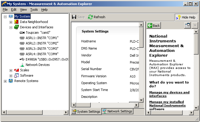

I'm having the same problem with a slightly newer version of MAX. Did you ever find a solution or workaround?
The camera works fine in the AmScope app, but crashes MAX when I clicked on it in the list on the left (Toupcam "cam0" in the screenshot below).

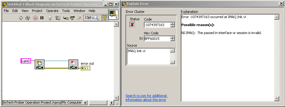

Relatedly, I am unable to connect to the camera through the IMAQ library. I get error -1074397163 "The passed in interface or session is invalid."
