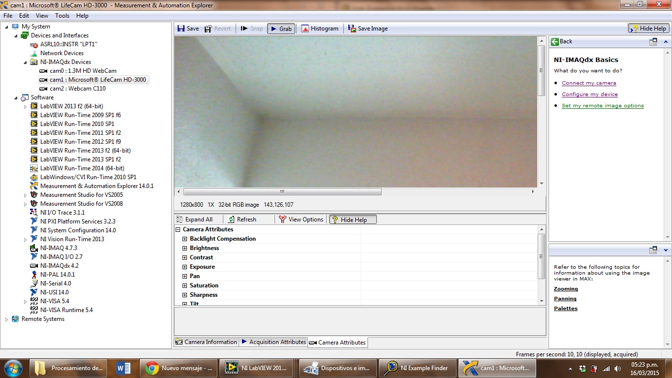

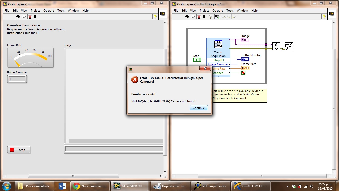

I've been using USB cameras with labview 2013, and I can acquire images in the MAX, and in the Vison Acquisition (express) settings, but when I run the VI, always appear the same error as shown in the Image below.

Since you are using an Express VI, right-click, and open it so you can view the LabVIEW source code of the VI.  You may find that the express VI contains a different name than your camera, or possibly something else.

Are you running in 64-bit LabVIEW? MAX and the Express VI are both 32-bit, I believe, and it might be possible that your camera doesn't have working 64-bit DLLs (since it looks to be a DirectShow-supported device).

Thanks for replay MoviJOHN, I checked the name, and it was correct, also I tryed to rename the camera and get the same error... I don't know what's wrong.....

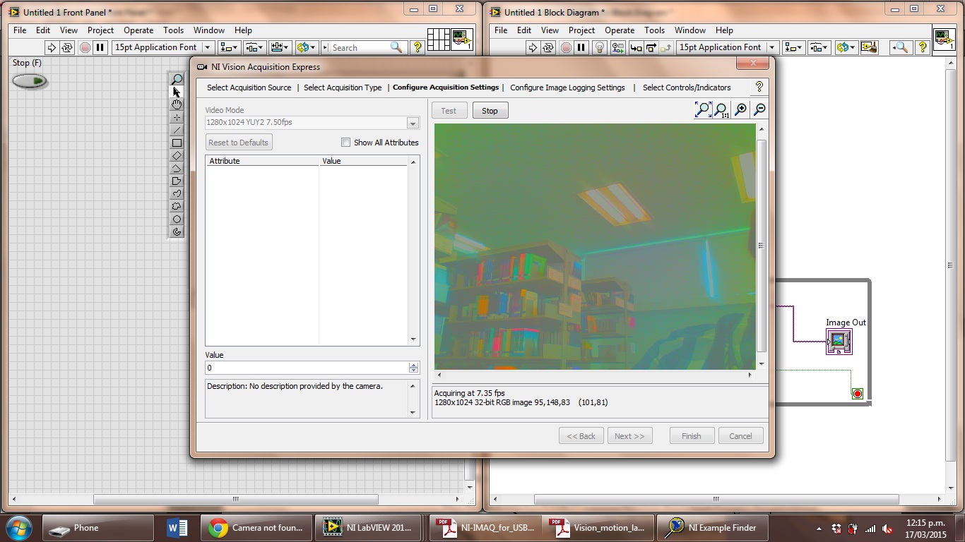

The strange is that I can acquire images when I'm setting the Acquisition Express, but the Error appears just when I run the VI

If it works in the pop-up Express VI app and inside MAX (both 32-bit apps), then I am assuming it will work within 32-bit LabVIEW. It is unclear why it is not working in 64-bit LabVIEW, but it is up to the camera drivers and other Windows infrastructure/DirectShow pieces.
