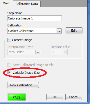

If your image size varies and you're using a Simple Calibration, you can now (in VBAI 2012 and later) simply check the box to allow for Varying Size Images in the Calibration step.
So you shouldn't need to use a Run LabVIEW step to calibrate if you're using VBAI 2012 or later.
